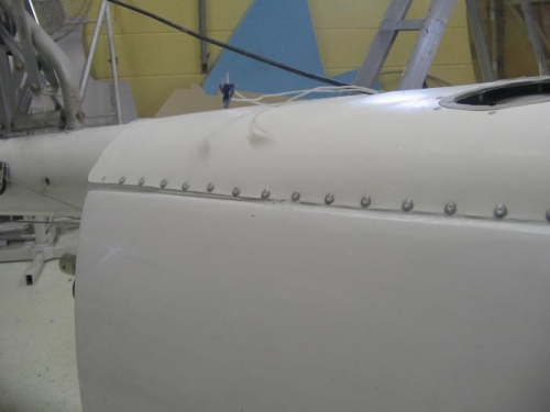

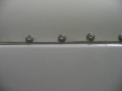

silicone seal rivets and turtle deck to hull joint
Sealed turtle deck to hull join with All Clear sealant and filled all rivets on turtle deck and side cover with paintable silicone to prevent corrosion and egress of water.
silicone filled rivets
silicone sealed turtle deck to hull
