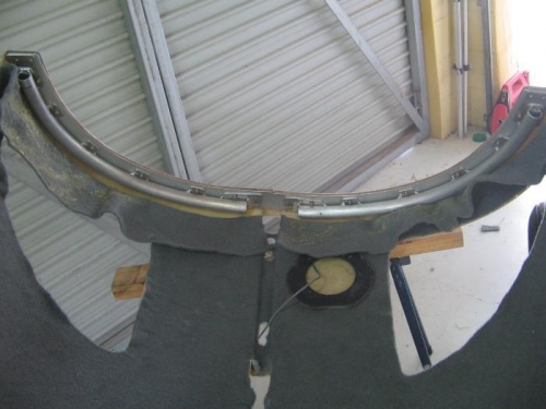

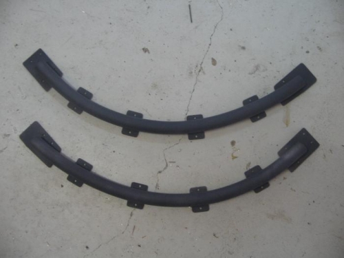

Brief Description:  turtle deck arches
Received ally arches from Southside Steel Fabrication in Sydney as per Rob Loneragan's drawing. This arch is designed to stop most of the flex from wing through to the turtle deck. Bolted into position with AN3 stainless round headed bolts and nyloc nuts. Once all holes were drilled I removed the arches and etch primed them then bolted back into position before fitting the turtle deck to the hull.
arches bolted into position
removed and etch primed
