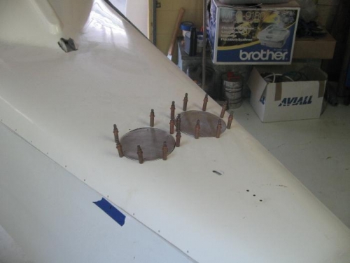

Brief Description:  rear turtle deck inspection hatches

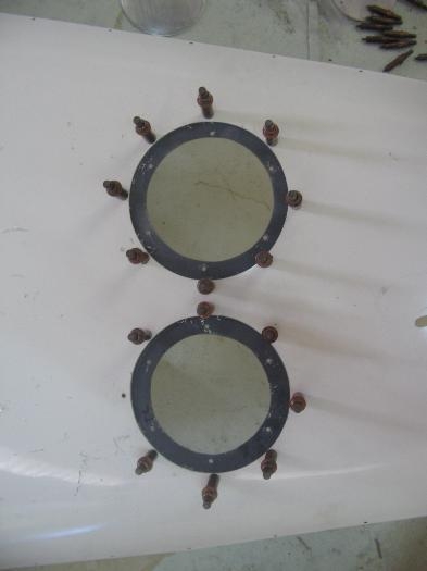

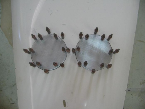

As there would be no access to the rear of the turtle deck once fitted I made up some inspection harches to provide access. The main purpose for this is to be able to replace the retraction cable and bungy pulley if needed. Sealing will be done by using a thin rubber gasket with a non hardening sealer. In all likelihood they shouldn't have to be removed for a long time.
ally supports for covers in place
with covers in place
different angle
different angle
