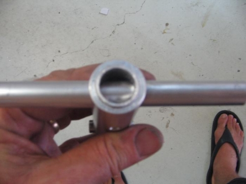

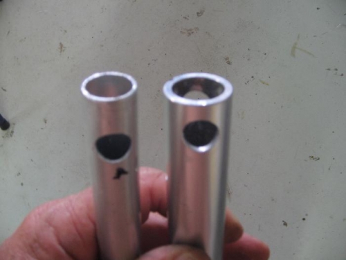

flap horn bushing
Fitted bush to top of flap horn to reduce wear/slop. The arm will not turn now so all movement will be on the rod end.
hole drilled in bush
ready to insert
with arm fitted
