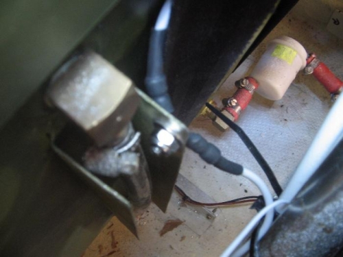

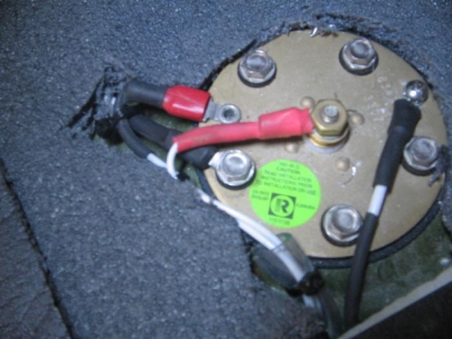

To bond the fuel tank I ran a 10 gauge wire from one of the fuel sender fixing bolts to the visual fuel indicator mounting bracket then to the ground bus.
fuel tank sender
ground bus
