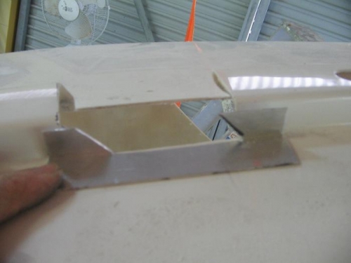

upper turtle deck supports
Added alloy angle to upper turtle deck where diagonal root tube goes through for 2 reasons......
1. to fill cut out where too much material was taken out so that there is material to rivet side covers to
and
2. for extra support for diagonal root tube angle brackets where turtle deck attaches with bolts
L & R brackets
LH bracket
attached to underneath turtle deck
