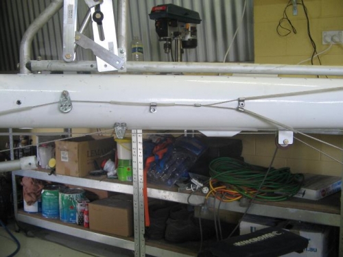

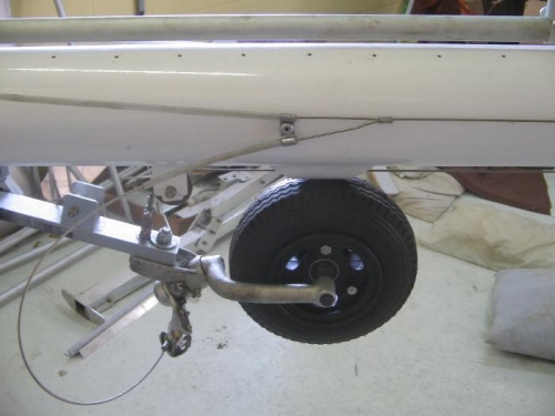

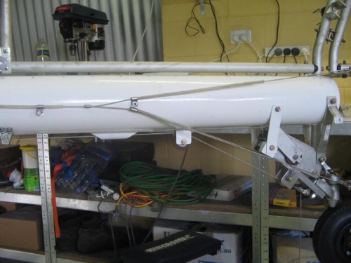

rear rudder cable attachment points
Attached rear rudder/tailwheel cables to boom tube with 1/4 ally rivets spaced with 2 x AN4 washers.
