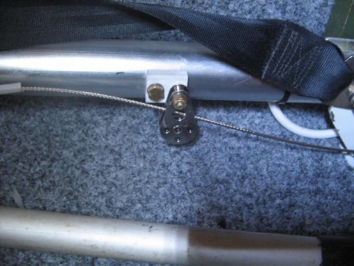

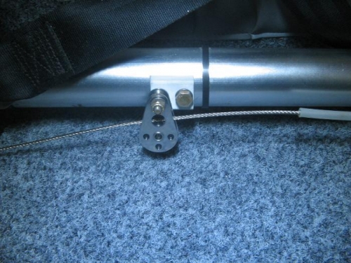

rudder cable pulleys
Made up mounting brackets and fitted RF418 pulleys to left and right forward tubes to ensure that the rudder cables run smoothly through the bulkhead pulleys without touching the lower body of the pulley and creating wear..
pulley mounted left hand side
pulley mounted right hand side
