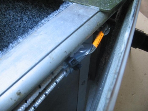

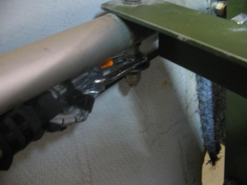

bungeee cord adjust
Adjusted bungee cord tension as found that the tailwheel was hanging down off the boom tube slightly so added more tension. Also added plasitic tubing around bungee where threaded through tie off points to reduce possible wear of cord.
bungee adjusted and tied off
plastic tubing around LH attach point
plastic tubing around RH attach point
