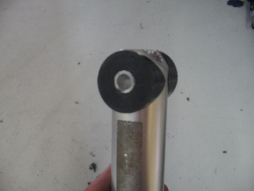

bushing flap horn
Drilled out pivot hole on flap horn and fitted alloy bushing to stop wear at pivot point. Drilled out spacers to fit bush.
bush fitted to flap horn
drilled spacers

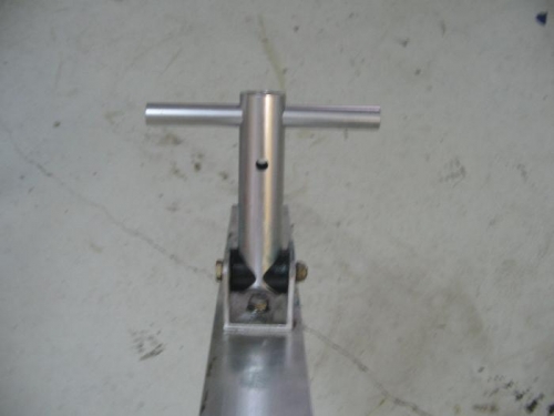

fitted to channel bracket
