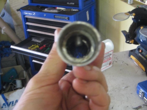

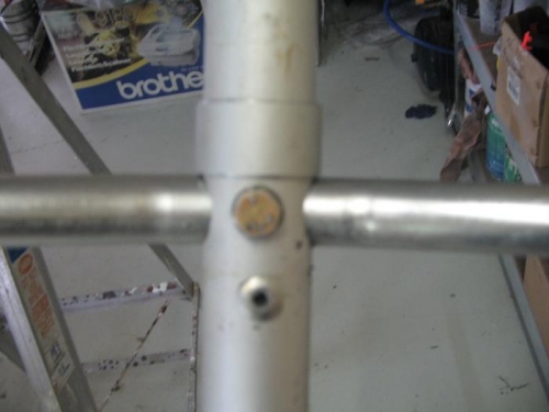

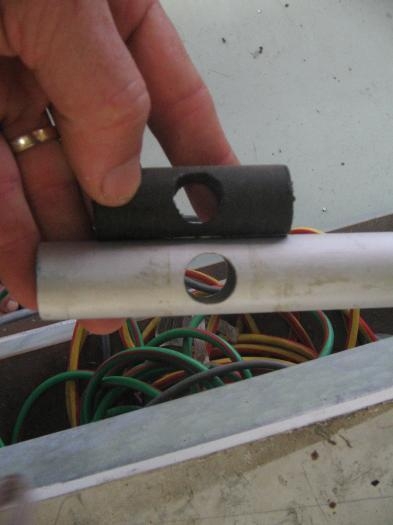

Had nylon bushing for top of aileron horn turned up on a lathe by IBS engineering Innisfail. Drilled 5/8" hole and tapped into place then drilled bolt hole, fitted retainer ring and rivet and also added another rivet to stop any movement.
Made and fitted internal alloy bush to bottom of horn.
nylon bush ready to insert into tube
arm refitted with retainer ring and extra rivet
internal bush fitted to base of aileron horn tube
