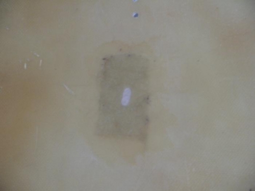

Brief Description:  fibreglass doubler for turtle deck
Fitted a speaker to the underside of the turtle deck by first fibreglassing another layer of glass for strength and then fixing a speaker mount to the glass.
I also added another layer of glass where the fuel filler and vent bolt on as it is very thin and the filler tube puts a fair bit of pressure on the turtle deck and I believe it would crack over time. Also addeed layer to hole where trim cable and trim wiring goes though.
speaker mount
speaker mount
fuel filler
fuel filler
trim cable hole
trim cable hole
