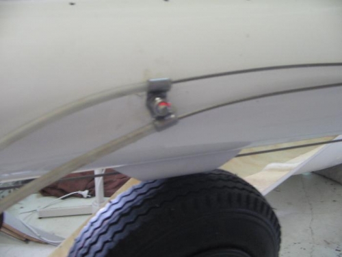

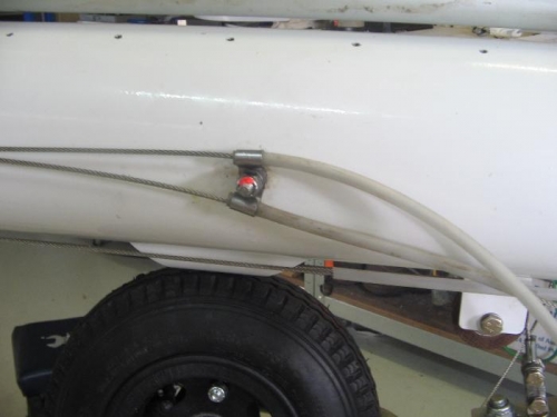

rudder/tailwheel cables
Replaced 1/4 rivet with stainless 1/4 bolt & nut where rudder/tailwheel cable splits on rear of boom tube as I believe that the rivets would work loose over time.
left hand side
