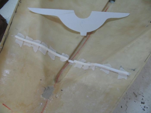

cargo deck rear trim support
Fibreglassed 13mm foam backer rod to turtle deck to support rear trim
glued on with AV adhesive

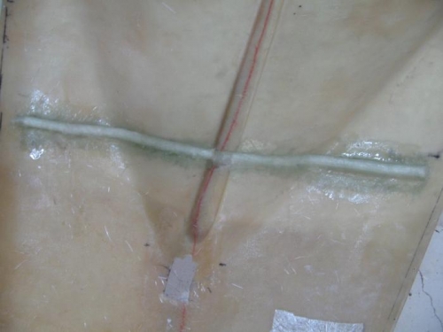

fibreglassed
