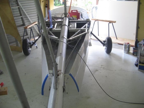

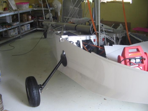

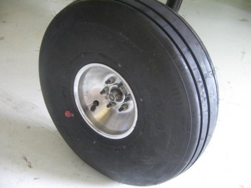

I needed to check the angle of the fuel filler hose when the plane was on it wheels so decided to assemble and fit the main wheels. Coated the inside of the wheels with lithium grease before fitting the tyre as per Rob Loneragans instructions to prevent the inner tubes from sticking to the wheel over time.
Made sure to line up balancing dot with filler valve.
