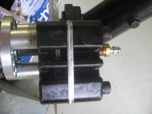

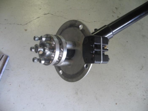

Assembled and fitted brake assemblies. Had to file small high spot on left hand brake disc rotor as was just touching on outside pad. Made new 1.6mm shim and removed 1 factory supplied shim to stop pads binding on RH disc rotor. Both rotors run freely now with no binding.
Applied lithium grease to cavity between wheel bearings and ardrox to all bolts.
left hand side
left hand side
right hand side
right hand side
