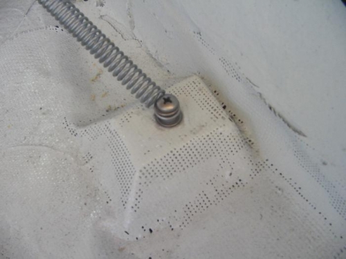

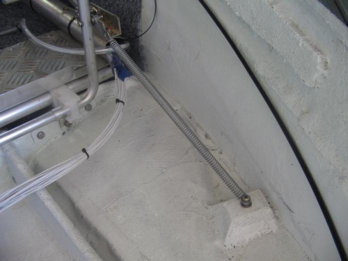

Didn't like the way the manual recommends to use #10 x 3/4 sheet metal screws to attach rudder pedal springs to hull as they don't protrude into mounting block far enough. Also once a hole was drilled through the carbon fibre there is nothing but foam so I bought longer SS screws and fitted washers between screw head, spacer and hull and poured resin into drill hole before screwing screw in.

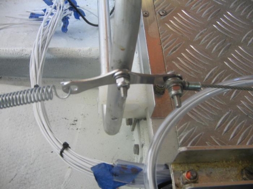

Also adjusted rudder pedal forward by adding tang to rudder cable as I feel that the pedals were positioned too far aft for my legs.
rudder spring
rudder spring
rudder spring using longer crew and washers
tang attached to rudder cable.
