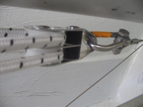

Used new 8mm bungee and double nylon pulley for retraction system. Tied the ends off by wrapping rubber strips around and cable tying so that cable ties won't cut into bunge over time.
bumgee tied off with rubber strips and cable ties
double nylon pulley
