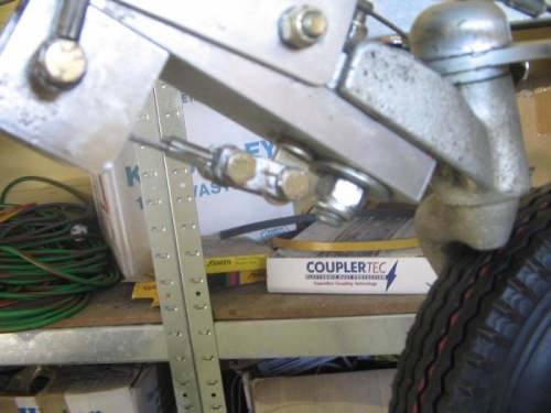

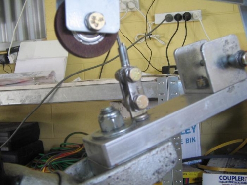

Brief Description:  retraction cable attachment point brackets
When the tailwheel is retracted the cable puts sideways pressure on the pulley due to how the cable is attached to the eye bolt. I didn't like this situation as I believe over time it could cause the pulley to fail.so I made up 2 stainless brackets that bolt on between the eye bolt on the tail strut and to the end of the retraction cable. Cable pulls straight now with no sideways pulling on the pulley.
stainless brackets in retracted position
stainless brackets in extended position
