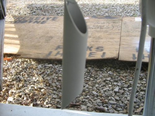

tailwheel tyre rest

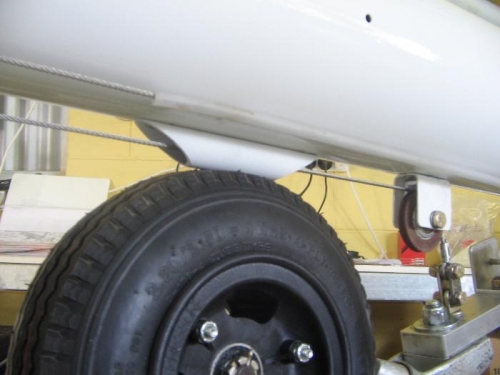

Made up tailwheel tyre rest so that the tyre doesn't squash the retraction cable when in retracted position. Attached with 4 x 5/32 stainless steel rivets for extra strength as it will take a beating over time.
tailwheel tyre rest etch primed
tailwheel extended
tailwheel retracted
