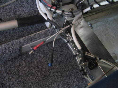

Connected bilge pump to electrical system and checked operation. Used blue size bullet type terminals for easy disconnection of bilge pump wiring and sealed with liquid electrical tape and heat shrink.
bullet terminals on wiring side of bilge pump

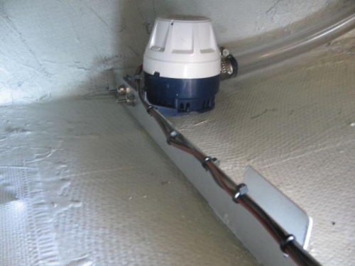

bilge pump in position with wiring attached and waste hose fitted

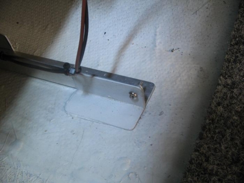

attachment point
attachment point
