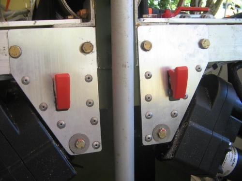

Brief Description:  emergency gear overide
Installed emergency landing gear overide switches and wiring to be used if landing gear fails to operate. These switches will cut power from the relays to the actuators so that power can be sent straight to the actuators bypassing all other wiring and switches.
emergency gear switches locked
emergency gear switches unlocked
