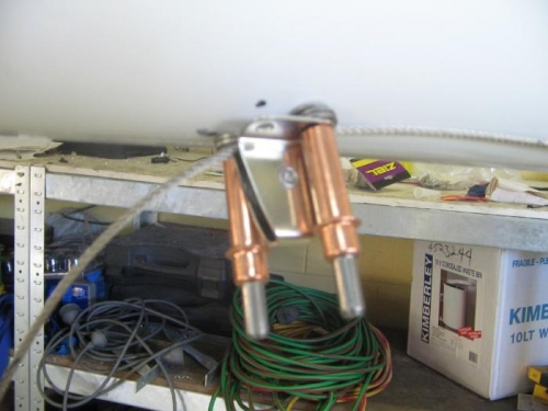

Connected retraction and extension cables. Fitted pulley to underside of boom tube for extension cable with clecos and measured cable path for accurate cutting of hole in transom. Also cut hole in transom for cable retraction cable. Retracted and extended gear successfully.

pulley for tailwheel extension cable clecoed in place
