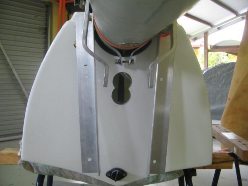

Brief Description:  boom/transom attachment angles
Made new aft hull attachment angles from 3mm x 30mm ally angle and clamp plates for inside side of transom from 3mm x 25mm ally flatbar. Also made collar for boom tube where aft angles attach from 3mm x 25mm ally flatbar to stop the bolt slicing through the boom tube in an accident. Holes will be drilled in transom for angles when in final position.
collar
collar
