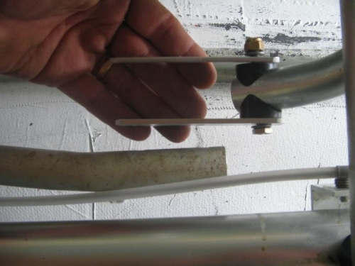

Brief Description:  elevator push pull
Fitted elevator push pull to frame and measured position to cut hole in transom. Found that push pull tube needs bending into position as not lining up with control column torque tube. Filed down RH bottom corner of push pull tubre guide on lower bulkhead as too close to hull.
push pull tube not lining up
