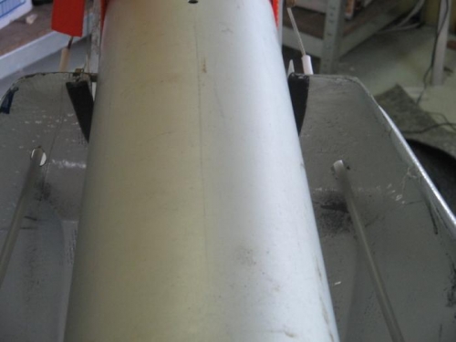

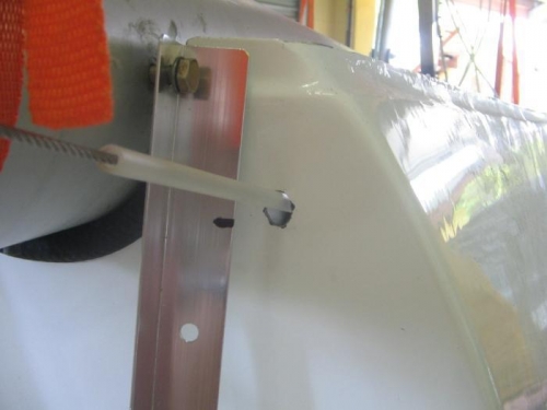

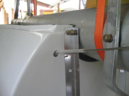

holes in transom for rudder cables.
Measured in situ position of rudder cables in relation to boom tube then lowered frame into hull and drilled holes in transom for rudder cables. Holes aligned perfectly.
LH side
RH side
inside
