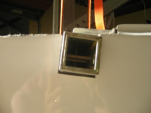

upper bulkhead fitment
Sat frame in hull and filed away bulkhead cutout to ensure that when frame is bolted in it doesn't touch the cutout as I believe that if allowed to press against any parft of the cutout will eventually result in cracking around this area.
left hand cutout
right hand cutout
