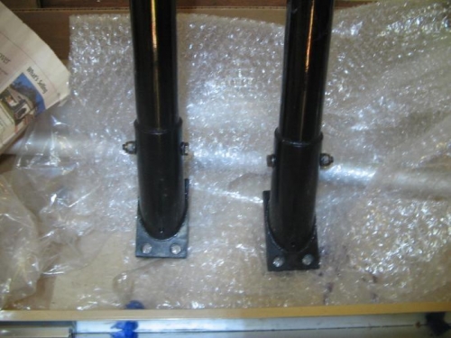

Brief Description:  Fiiting spindle housings to gear legs
Attached spindle housings to gear legs by first coating bottom of gear legs and inside of housings with Sicaflex then pushed legs into position and bolted on the AN4 bolts. Ensured that top of housings were sealed with Sicaflex around gear leg. Both bolts, nuts & washers were liberally coated with Sicaflex to ensure no egress of water between gear leg and hosusing.
gear legs with spindle housings attached
