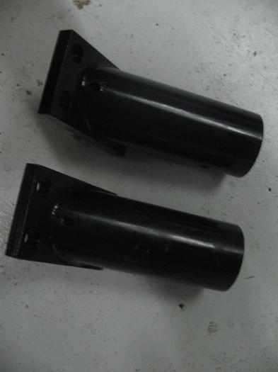

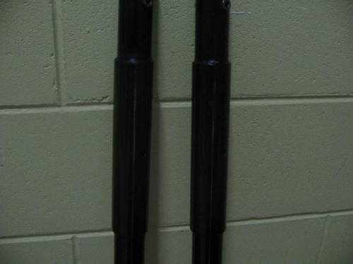

Sealed gear leg sleeve with Sicaflex. Drilled drain hole in main gear spindle housing. Coated insides with 2 pack urethane paint again.
sealed gear leg sleeve
sealed main gear spindle housing
