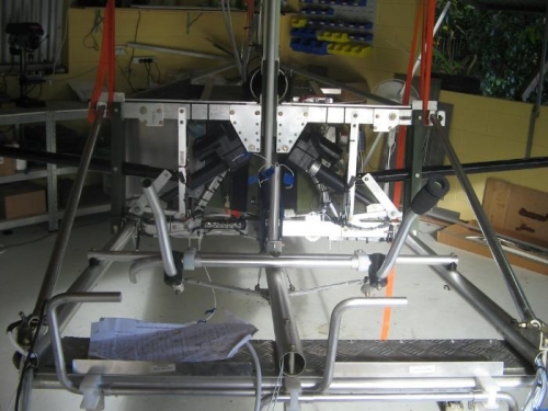

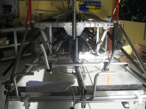

Brief Description:  landing gear check
Once wiring was completed I checked operation of the gear. Found that LH side wasn't working and traced fault back to bad conection on actuator plug as lug was not clipped into the plastic plug properly. Refitted and checked correct positioning of lug into plug. Checked gear and all working well.
gear down
gear down
mid way
mid way
