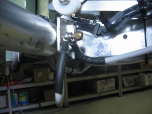

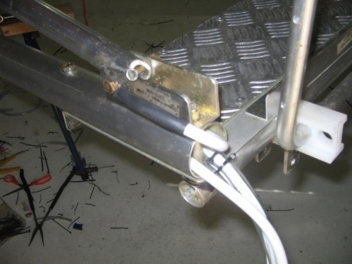

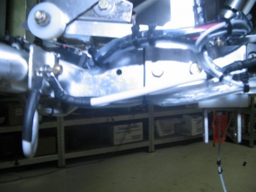

Brief Description:  ground wiring
Used 4 gauge cable to ground airframe by using cable that I had previously run through the forward tube by crimping on lug and bolting it through the upper cockpit tube attachment bolt. Connected rear of cable to rear forward tube seat belt bolt with lug and ran another cable to ground bus.
ground wire
ground wire
ground wire to bus
ground wire to bus
from front then to bus
