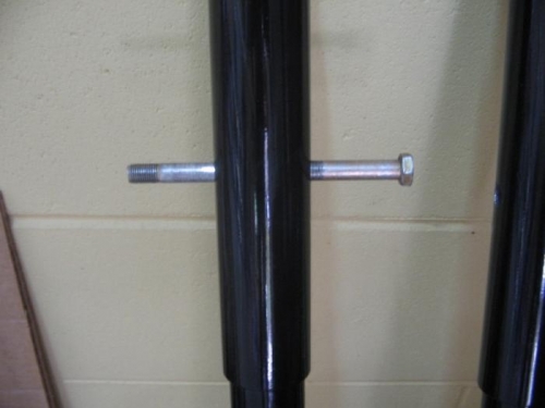

stainless bolts to gear leg
Drilled out gear legs at pivot point to allow for slightly larger stainless steel bolts. As aother Searey buildersd have complained that the holes are elongating in the leg stainless bolts should wear less on the gear leg.
stainless bolt through gear leg
