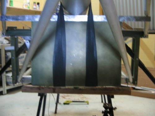

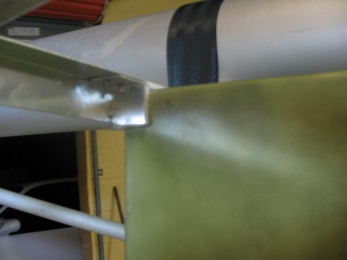

Fitted fuel tank. Soaked 2” seat belt webbing in water overnight so it would shrink when dry and tighten firmly against the tank. Anchored both ends of webbing with 2 x stainless self tappers and washers. Made holes for screws with a soldering iron. Also fitted angle brackets at each corner to stop any sideways movement in flight
fuel tank aft
fuel tank aft
webbing
webbing
movement brackets
movement brackets
