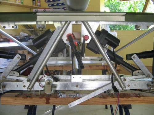

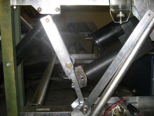

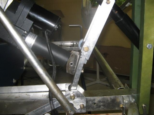

Manufactured lower actuator bracket for left hand side, fitted and tested it. Very happy with over centre positions on both sides and that when the actuator is fully retracted, it sits firmly on the spacer pad. When the actuator is fully extended, the retraction bar is positioned approx 12mm from the lower bulkhead. Drilled a new hole through the spacer pads. retraction bars and brackets for fastening top of brackets. Used stainless steel bolts and nyloc nuts. Disassembled both sides and coated all parts liberally with Ardox and reassembled
right hand side
right hand side
both
both
left hand side
left hand side
