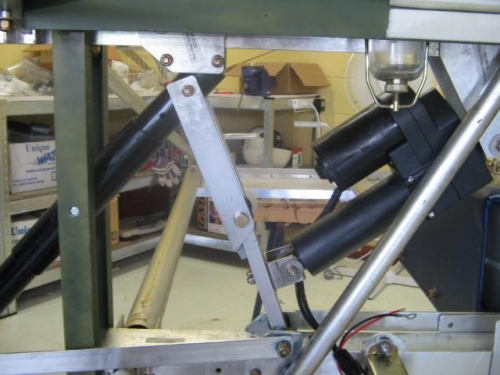

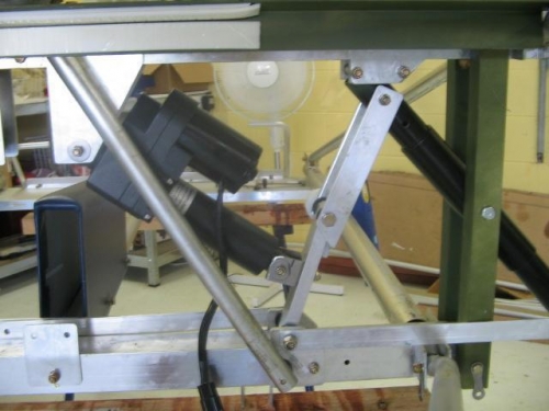

Assembled lest and right gear assemblies and checked over centre with gear extended. Still not happy with degree of over centre and also the fact that if the microswitches/current relays fail, the retraction plate will be forced into the lower bulkhead with great force so have I decided to make up new actuator attachment bracket and reposition mounting points so this will be impossible to occur.
How to work out where to position the new brackets was provided by Paul Wlliams, a fellow Searey builder.
