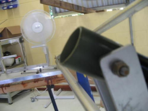

Brief Description:  right hand gear leg mod
Fitted compression tubes to right hand side upper actuator mounting bracket for firm adjustment of top of gear leg purposes. Had to grind down top of gear leg for clearance of inner compression tube. Added extra flat washer for future adjustment purposes (nylon pad will wear over time) as bolt slightly too long
compression tube
compression tube
gear leg mod
gear leg mod
gear leg mod
gear leg mod
