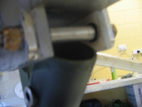

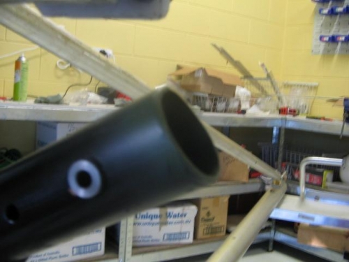

Brief Description:  left gear leg mod
Fitted compression tubes to left hand side upper actuator mounting bracket for firm adjustment of top of gear leg purposes. Had to grind down top of gear leg for clearance of inner compression tube. Added extra flat washer for future adjustment purposes as bolt slightly too long
