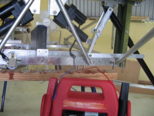

Date:  2-17-2008
Number of Hours:  1.00
Manual Reference:  PH
Brief Description:  actuators
Tested electric gear actuator for travel. In fully retracted (gear down) position, actuator goes to full retract position and engages clutch. In fully extended (gear up) position retraction plates will hit lower bulkhead. Contacted Warner Linear Actuators in the US and AUS trying to find if this particular actuator can be fitted with a factory current relay switch. Unsatisfactory answers from AUS distributor. Will follow up again with Warner US.
