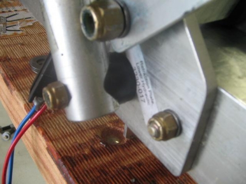

After fitting gear actuators found that diagonal support tubes touched actuator body so fitted 3 plastic spacers to bottom and 2 spacers to upper attachment points to maintain clearance. Have to order longer AN4 bolts for diagonal support attachments
lower diagonal
lower diagonal
