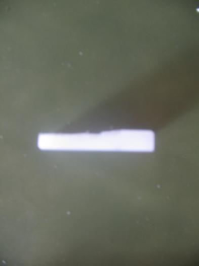

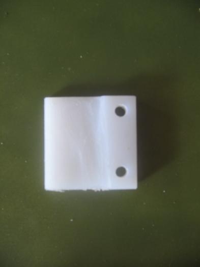

Over centre
Checked over centre position of right hand gear and decided to file down nylon spacer pad that the retraction bar rests on when the gear is down. Approx half the pad was filed down to give a couple of more degrees over centre
spacer pad
spacer pad
