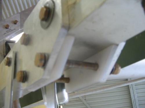

Fitted upper retraction plates to upper bulkhead. Used bolts instead of rivets to attach main gear wear pads to upper retraction plate. Will fit crush tubes later when time to adjust snug fitting of gear leg
used bolts instead of rivets to retain spacer pads and to stop the spreading of retraction plates
