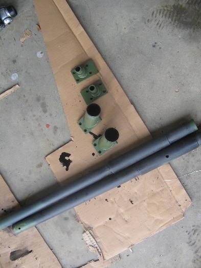

Brief Description:  Painting inside gear legs and spindles
Rust converted all bare metal parts with Fertan, etch primed exterior surfaces then coated insides of gear legs and main gear spindles by mixing up and pouring 2 pack polyurethane inside and rolling it through with same procedure as Linseed oil.
coating inside legs and spindles with 2 pack paint
