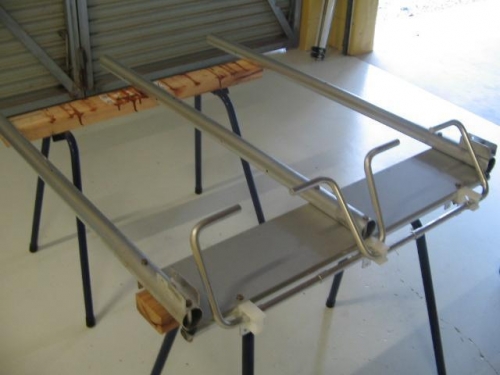

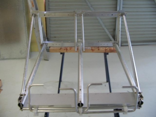

Completed most of forward cockpit assembly including floor pan, floor pan support angles. Fitted crush tubes to all accessible tubes. Used AN4-22a bolts to bolt lower inboard and lower outboard Cockpit tubes to floor pan plus extra rivets for floor pan support and heel supports. Bolted forward cockpit to bulkhead. Riveted positioning collars to rudder pedals
