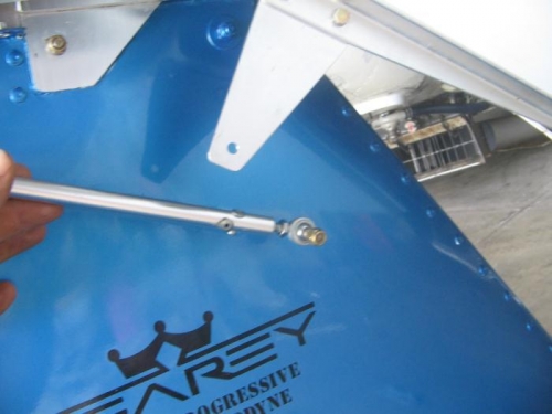

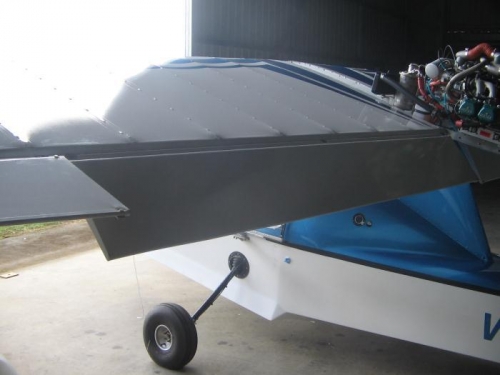

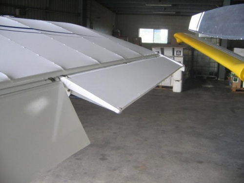

Fitted flaps. Very confusing re how to attach the tie rod to the flap horn as no instructions in the manual. Ended up using an AN-14a bolt with an 18mm spacer to straighten up the angle between flap slave horn and flap horn. A shim was added to underneath of each hinge to gain clearance from the trailing edge of the wing.
Fender washers were added to the rod ends in case of failure.
left flap
left flap
right flap & aileron
flap horn
flap horn
