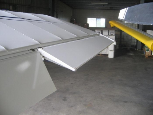

Brief Description:  fitting ailerons
Fitted ailerons. I didn't have to add extra shims under the hinges for the gap seal to clear the trailing edge of the wing. Very frustrating trying to adjust the ailerons as the balance weight was hitting the underside of the wing in full up deflection. After much adjusting the control stick hits my leg in both directions without interfering with anything else.
Fender washers were added to the rod ends in case of failure.
left aieron
left aieron
right aileron
