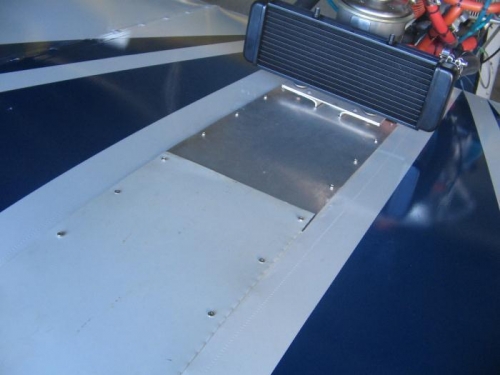

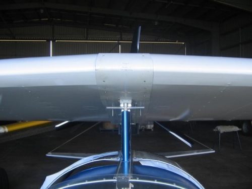

Brief Description:  upper gap seal fitting
Had to add extra length of gap seal as factory supplied was too short due to different coolant radiator location and will make access to upper pylon easier. Added rivnuts to angles and used M4 stainless bolts to fasten and will also use Loctite to ensure they don't come loose and go through the prop..
rear section gap seal
front & rear section
front view
front view
