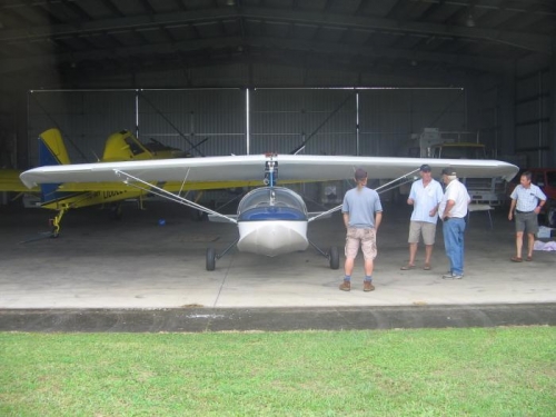

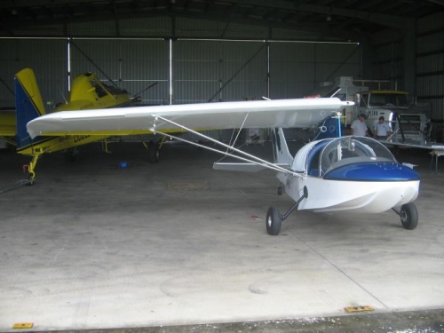

Attached wings to fuselage. Having 5 people made the job easy by sliding the wings onto the rear angle first then front angle then into the bulkhead. Upgraded upper attach bolts from AN4-26a to AN5-26a
