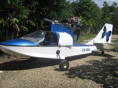

Started the engine after a couple of months to check new oil pressure sender and warning light on dash. Engine ran rough and wouldn't idle without full choke. Suspected crud in fuel bowls so removed and cleaned fine red sludge from bowls and jets. Engine now idles without choke but still a little rough so will clean again when at airport.
