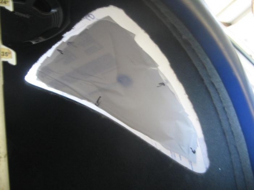

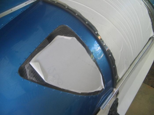

Fitted side windows using ABL 4-2 rivets with stainless washers on the inside and silicone sealer for waterproofing. Glued interior trim in place with contact.
right side
left side
inside
