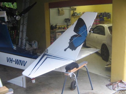

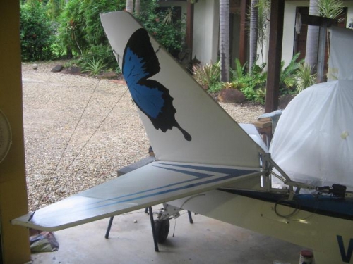

Brief Description:  fitting stabs
Fitted stabs. Took a while to get the stay wires at the right tension. Ended up twisting the top wires approx 3 turns to tighten them and the bottom ones approx 4 turns. Added washers under the tangs and longer bolts making it easier to turn the wires on the tang and not damage the fabric.
